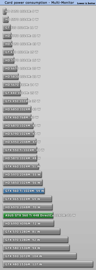

Yup, Fermi GPUs use quite a bit more power when hooked up to dual monitors:
You can try setting a new profile in something like MSI Afterburner for idle state, I believe the memory clock doesn't downclock.
