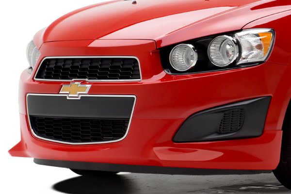

I bought a new car last year in PA and it did not come with a front license plate holder (PA only requires a rear plate). I'm moving to NJ next month, which requires that I have both a front and rear plate.
What are my options for mounting my new front plate? I'd prefer not to drill into the bumper myself. Would a body-molding adhesive strip like this work?
FWIW I have a 2012 Sonic, and the front of the car looks like this:

Your local Chevy dealer should have a license plate bracket for your car. Many states require this, including California. Personally, I don't like the way a license plate disrupts the look of a car from the front but I also don't like getting pulled over and ticketed either so I have one on my car.

I made one for my car that attaches to the front tow hook attach point, I used stuff from Home Depot. The contraption comprises of washers, toggle bolt, and strip of metal; cost about $5.

You may find that there are two dimples in the front bumper for you to mount the license plate already. All you need is two plastic screws which the dealership will probably provide for free and you can screw them right into the plastic bumper.

It comes with the car. All new cars do...they don't build them according to the state they'll be delivered too (...except CA), so they come with the front plate, as well as the documentation, usually the floor mats, and other little bits stuck in the trunk.
Most techs leave them in the trunk when they do a PDI. OP should check the general vicinity of his spare tire. Still have to drill, though. There are tapes that would work, but I wouldn't put them on paint.
I'd just go through the black plastic on the front of your car. If you need to take it off, just stick some trim clips in the couple of holes you made (the 'christmas tree' kind with the plain smooth head). Hard to notice.
