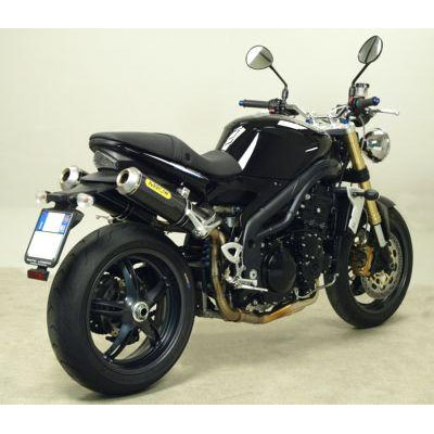

Almost all aftermarket pipes are some variation on a straight pipe. This means less baffling and in the case of newer bikes removal of a catalytic converter. This is why the pipes are louder. Some pipes have noise reducing inserts that add back baffling making them slightly less restrictive than a straight pipe, but still louder.
Stock the engine is tuned for the back pressure in the stock exhaust, and as lean as possible for emissions requirements. When you swap out for an aftermarket exhaust you lean things out even more, because the engine will breathe better with less back pressure. You need to rejet bikes with carbs, or reflash the ECU on a fuel injected bike to run richer.
What you end up with is a bike that gets less MPG and is louder. You might gain 5-15 HP depending on the make/model, but bikes already have amazing power/weight. In almost all cases you you will lose some MPG, because the bike is tuned richer.
I dropped @15lbs from my bike with a low mount GP style pipe, and it is only marginally louder because I am using a baffled insert. I lost some low end grunt (due to the physics of shortening the overall exhaust run) and picked up some top end.

I think the Triumph exhaust is sexy as hell. I have no idea why you swapped it out for that ugly short pipe.
Funny you should mention that...
I removed the stock exhaust because there is a cat in the mid-pipe (below foot peg), and one in each can. It completely ruins the rip/growl of the triple sound. I got a great deal on the CRM low mount, so it was a quick fix.
Since then I have pickup up a straight y-pipe, and I have been watching ebay and the S3 forums for a set of cans (Leo Vince, CRM, Wolf, or Arrow). :biggrin:

I like the high mount dual pipes. I think the Arrow is a low mount single pipe if I'm not mistaken.

That stock exhaust is probably one of the nicest looking stock exhausts out there. I bet that Arrow would sound great though.
