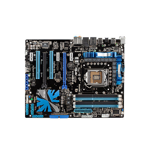

Here's how it goes:
1. it whines when the browser is open or if I run an HDD benchmark
2. the whine stops if I run SuperPi while the browser is running
3. reading PDF and using word doesn't cause whistling
4. skype causes whistle when in a conversation
5. sometimes it stops even while using firefox, the sound is a continous whine, except when I start the computer where it's a bit more creative for a few seconds.
I'm thinking it's the motherboard because it's not the SSD for sure and I don't see why the other components would start being noisy now since they're unvariated.
I can't see any coils on this thing, but there are several heatsinks on the mobo.

inside the case, I'm sure it's not the SSD because I tried two of them, and the graphic card has no reason to start whining right now, but the motherboard had various changes applied to it (addition of a SATA device and cmos clear, so voltage changes).
I don't think it's the PSU because the sound comes from the area covered by the big square heatsink:
The sound is clearly coming from the case, the speakers can be turned on, off, the noise is there, and it's localized inside the case to a specific area. And through the in-ear headphones I hear no noise even if I blast the volume.
