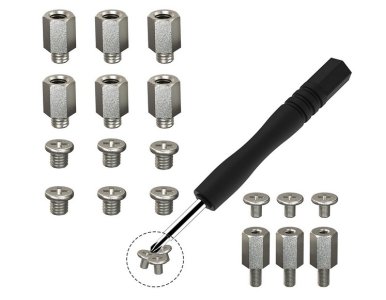

I have a gigabyte z590 ud ac that came with heat sink for SSD.
My SSD would not boot from that 1st m.2 slot
But the other port has no way to mount the heat sink to the motherboard and I can not remove the one near the cpu
The SSD doesn't run hot (35C) but thought I would use the heat sink
Where can I find the standoff for the heat sink screw or does other aftermarket sinks mount different?
thanks
