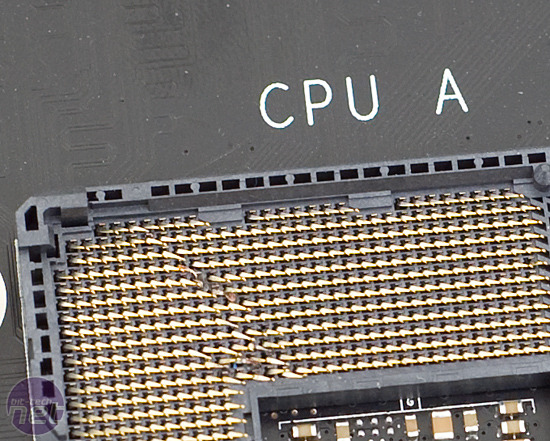

1. Pins reflect light, so when one is bent, it's very obvious. You know if you look at the pins, it sort of has a cascade look to it.
All the pins are the same, but see how the top-right part sort of looks different than the bottom-left section? This is just based on how the light is reflecting off the angle. When a pin is bent, it sticks out like a sore thumb. You'd see the pin that looked like it belonged on the bottom, on the top, kind of thing. Like this:
Just google "lga1155 bent pin" or "motherboard socket bent pin" to see images of this stuff. You can also go on ebay, check out, say, p68 motherboard, then check out the for parts/repair boards being sold for super cheap, they'll often include pics of the boards with bent pins (the most common issue with for parts/repair boards).
It's actually extremely easy to fix bent pins. Just straighten it out, try to boot with CPU, if it doesnt work, bend it right. The problem is that pins are easy to break with too much moving, they can only be bent back and forth so much, before they just snap off (like a coke can top). This is still, a replaceable issue - with AMD chips, for example, just drop a piece of ethernet copper wire (not an actual ethernet cable, strip the ethernet cable down, and use one of the cables in the cables) and mash it into the motherboard socket pin to prevent it from contacting other pins, and walla, replaced amd cpu pin. But on Intel, you can't do this, it kinda sucks, a broken pin = throw the board in the trash.
