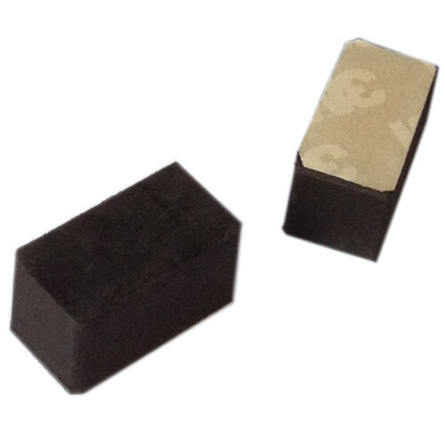

I love ASROCK motherboards. But yeah, this is bad design.
You can cut a long piece of styrofoam and slide it underneath the motherboard as support.
But these motherboards should come with some rubber feet like these.
Yeah, there's easy work arounds like that, but if someone is dropping $200 on board, they shouldn't have to worry about things like that.
