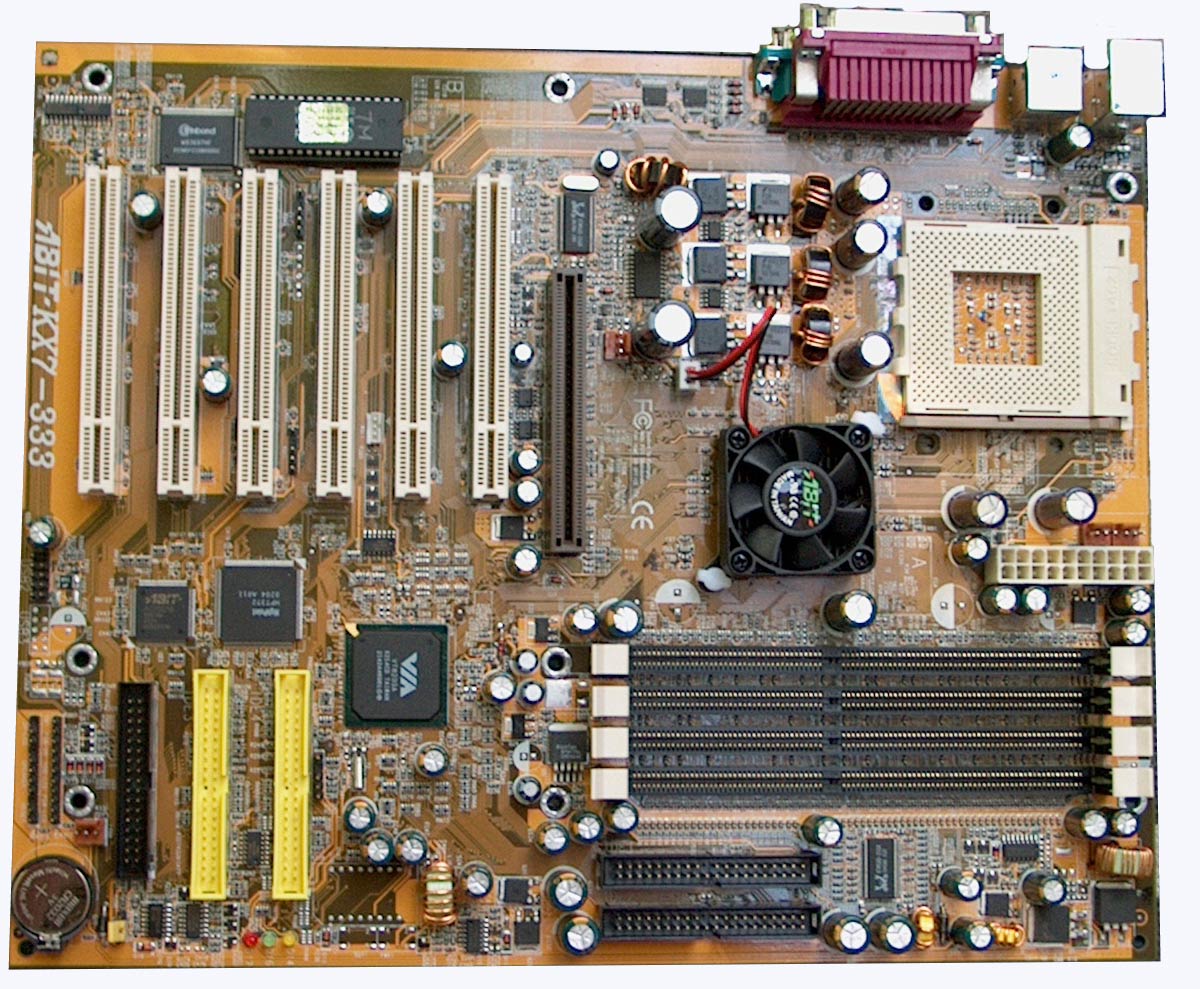

If I were you, I'd take the motherboard out of the case, lay it on cardboard, and hook up just the bare essentials: video card, one memory module, CPU and heatsink. No keyboard, no mouse, no drives, no case wiring (except the case's Power button). Like in this picture here. Yes, that ugly monitor belongs to me 😛
Make sure the board has both the regular ATX power cable and the ATX12V cable hooked up, and see if you can get a video signal or not here.
