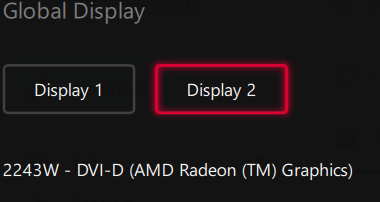

I took some screenshots from the AMD software on the 5500U laptop. It sees the monitor, but the monitor doesn't get a signal. HDMI to DVI should be 100% compatible, so I am confused as to why this doesn't work on the two newer laptops.

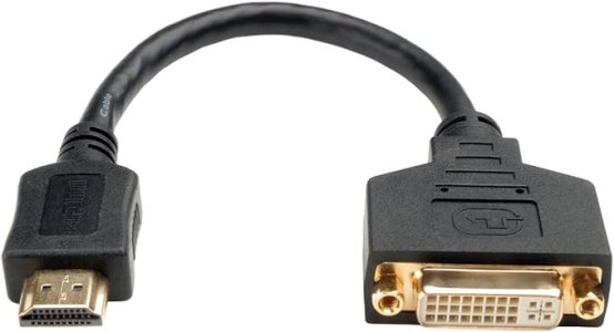

I got it to work. But, I don't know why it works. Looking through all my cables, I found a short male hdmi to female DVI-I (not DVI-D) cable like the one pictured below. I then used a DVI-D single link cable to connect that cable to the monitor. It came right on without any issue. As these are completely passive connectors, the only thing I can think of is the other converter must not have something connected right that the newer laptops were trying to use.

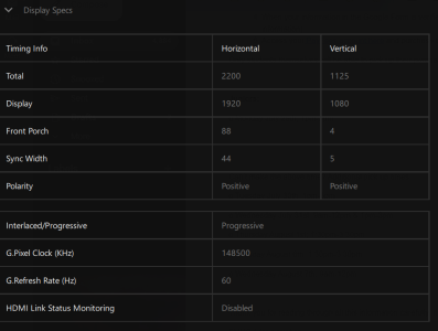

Never did figure out exacly what was the problem with the other one. But, I did manually try setting resolution and refresh rate without any luck. Probably about the only time I every need to use that old DVI monitor, so I guess it doesn't matter.
