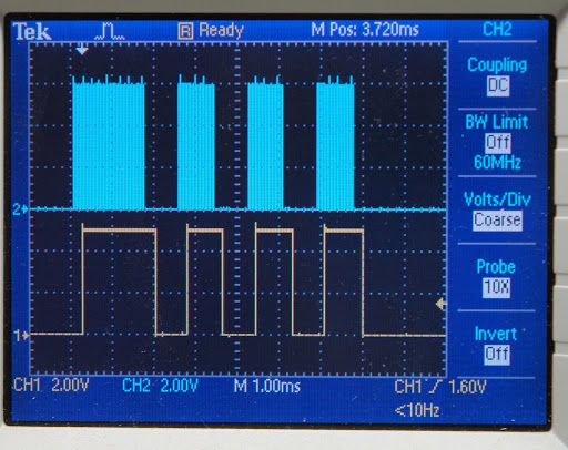

Have a small xtal osc like this, using the ubiquitous CD4069 and a watch crystal link.
Then run it and your digital signal through an AND gate [CD4081]. The output will be 32kHz when your digital signal is high, and nothing when it is low.
What is the speed of the data going to be though? The mod freq should be substantially faster.
Obviously with 32kHz you can't transmit at 115.2kbaud, 300/600/1200 baud is more like it.
output should look something like this. Yellow being data, and blue being the modulated output. (except the yellow will lead the blue, not lag, as in this shot)
