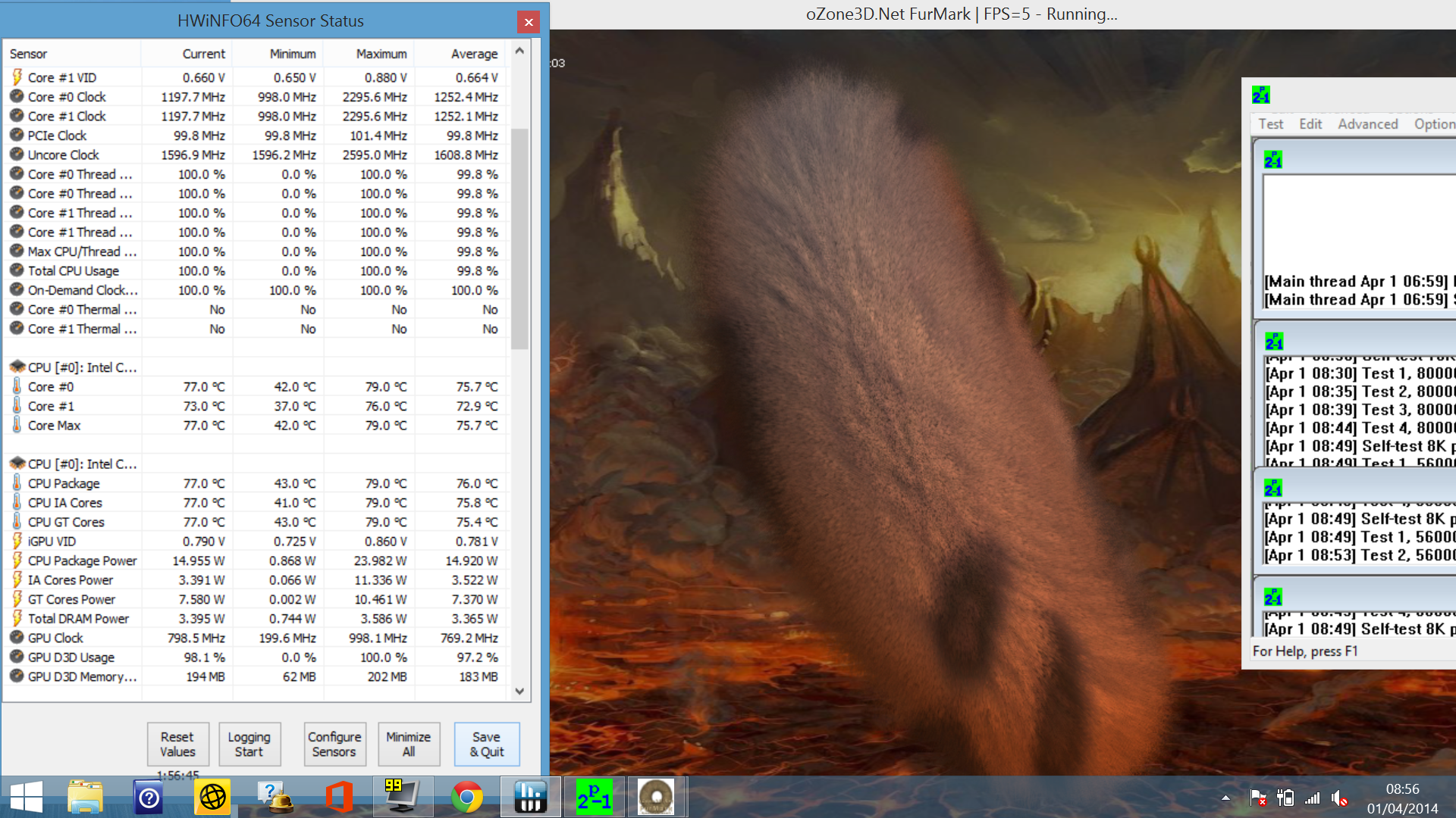

Hmm... A lot of the time ULV Haswell cannot maintain clocks under extreme load.
Looks like igp is prefered under load on this notebook. Short term turbo to 24W.
Haswell CPU is really efficient. Its the GPU that is disproportionately power hungry.
