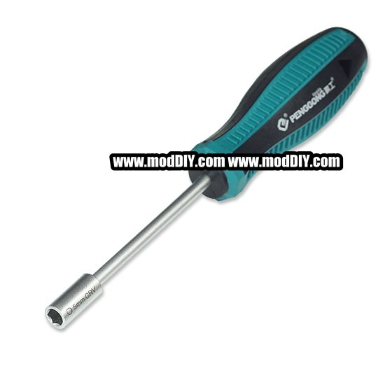

Option 2... goto a hardware store with your stand off.
Get a hex nut driver to match standoff diameter.
use 2 drivers... ^ on the standoff.. a regular one on the screw.. and pull it off.

A small open end wrench can immobilize the standoff while you unscrew the mb screws around the periphery. I have some 30-35 year old ignition wrenches I use for small things, but small wrenches are out there. A standoff is, about 5mm, right?
If the screws won't come out, you can turn the wrench to unscrew each standoff from the motherboard.
That center screw will be . . . interesting, though, if you do not have a cpu window so your wrench will reach the center standoff. You can always tape a wrench to the end of a screwdriver (or even a stick) to immobilize the center standoff if you do not have a cpu window to work with.
