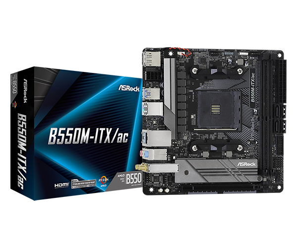

Any major downsides to the backordered ASRock B550M-ITX/AC AM4 you mentioned earlier? One of the reviews mentioned this. I wonder if he tried plugging in the cables before installing the MB.
Cons: -The power and reset button and power LED are almost impossible to plug if USB 3.0 is plugged. Once the mobo is in the case, and the USB connector is plugged, it is just too tight to reach and plug the remaining cables. I ended up only plugging in power with no LED or reset. -The book manual that comes with the board didnt have all the information I wanted, but I was able to find a proper manual online that showed what I needed. (Not sure what its called, but needed to find a "map" of the mobo to find the aforementioned pins)

Well I just backordered the ASRock B550M-ITX/AC AM4 motherboard. It won't be in stock for about 2 more days. If anyone sees that it won't work or finds a better deal please let me know.

Since your ram is on the QVL list for the board, it should run its rated speed easy peasy. I don't know what overclocking options you will have on an A series board, so let us know how that goes.
I don't know what case that complaint was about, but I had no problem connecting power, reset, or LEDs on the Fatal1y. They are standardized and I can do it in a few seconds after so many repetitions over the years. Dude sounds like a n00b to be blunt. If it is tough to connect them after connecting the USB 3.0, do them first then connect it. Duh! :p
I will be surprised if the board does not ship with a very recent bios. And a 5600g is a great match for that board.
