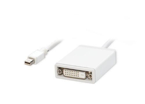

i just installed my 5870 and have been trying to test it out w/ some MW@H WU's. initially i had problems getting BOINC to recognize the 5870. my goal was to run the display with the onboard HD 3300 video, and let the 5870 do nothing but crunching, thus avoiding any GUI lag. but for some reason BIONC wouldn't recognize the 5870 while the 3300 was set to be the primary GPU...even with the 5870 connected to the DVI port on the monitor (and the onboard video connected to the VGA port). i can't use the dummy plug trick b/c all the DVI-VGA adapters i have won't fit/plug into the miniDP-to-DVI adapter that in turn connects to any 1 of the 6 miniDP jacks on my 5870 :mad:. i thought the pin-outs on all DVI connectors were the same up until now...what a rude awakening lol.
the DVI end of the mini DisplayPort-to-DVI connectors that came with my 5870 look like this:
...but i have to order one whose DVI end looks like this:
...because all of my DVI-VGA adapters look like this:
DrmHA1TQzFYKrOgjzAy_eJojrX88aEif4ljoiHSn3NRak8aFoFpA41MRjbolXQktXAm05h7phOF1a5nN14TSy8FlkIo1EjIRyQ5GQVzmylUHulNIeWoJWQ0pU69y_Qzk0O5DP97cm7uus1LQMTa-m5S_xgkttWfKfZl2AvUSKtJnDt625nIRpHGPRbleXGQygako
...long story short, my DVI-VGA adapters won't fit the mini DisplayPort-to-DVI converter due to the 4 extra pins surrounding the flat piece inside the DVI end of the DVI-VGA adapter. i'm hoping that this will allow me to run the 5870 as the secondary GPU and the integrated as the primary GPU, b/c it would let me do it by way of connecting both cards to the same display (one by DVI and the other by VGA). but i already have my doubts b/c the mini DisplayPort-to-DVI converter i need can only connect to DVI-to-DVI or DVI-to-HDMI cables & adapters, but not DVI-to-VGA, according to monoprice.com. i'm starting to think that the dummy plug trick is impossible to do with a video card that only has mini DisplayPort jacks on it :thumbsdown:...i hope i'm wrong about this. can anyone confirm or deny this? i could really use some advice here...*EDIT* - i found a solution - they make mini DisplayPort-to-VGA converters, which should work every bit as well as a dummy plug as the typical DVI-to-VGA adapter. i'll get one and let you all know how it goes...
at any rate, i ended up having to do exactly what i didn't want to do in the mean time - make the 5870 the primary GPU and have it run the display AND run MW@H :rolleyes:. but at least this gave me a glimmer of hope b/c BOINC finally recognized the 5870...and just as one problem goes away, another takes its place. BOINC downloaded 32 MW@H GPU WU's, but since then they've all been sitting there "ready to start." at one point i walked away from the computer to have dinner. when i came back, 1 of those 32 tasks was approx. 50% done, with 45 sec. down and 45 to go, and "waiting to run (0.05 CPUs + 1.00 ATI GPUs)." an hour later (maybe longer), i noticed the GUI lag pick up severely, so i knew the video card had gone back to work on a MW@H task. sure enough, the GUI lag went away not quite a minute later as the WU finished. so my question is, why is my GPU usage at 0% with 30+ MW@H GPU tasks in the que? and why is 1 of those tasks "waiting to run" at any given time when the GPU isn't busy doing anything else? shouldn't my GPU be busy all the time with this much work in the que? bottom line, what can i do to get my 5870 to crunch more that 45 seconds at a time ever hour or so?

as soon as my mini DisplayPort-to-VGA converter gets here, i'll be able to make a dummy plug out of it
so i got my miniDP-to-VGA converter on monday and ghetto rigged it with 68 ohm resistors from Radio Shack...and it works like a charm. it would have been nice to have been able to just use a standard DVI-to-VGA adapter...i would have saved $17. anyways here's what i had to get to accommodate my video card:
...so now that the DVI port on my monitor is free from the 5870 GPU, i've got the integrated GPU connected to it instead of the VGA port.
