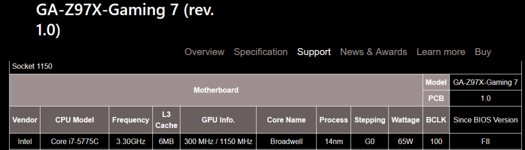

Along with the 6600 XT, I say pick up the Core i7-5775C from Aliexpress.com. It can take up to 3 to 4 weeks to deliver (may be quicker if you pay a bit more for shipping). Your mobo supports it:
This will breathe new life into your system and you can also overclock it above 4 GHz.

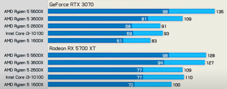

I'd honestly be worried about Nvidia driver overhead with that CPU. Everything is subject to change and it might get fixed in the future, but as it stands right now I'd avoid them.
That i3-10100 is going to be quite a bit faster than an i5-4690k even if it's OCed, and even that is trashing performance on Ampere. With older and lower end CPUs AMD is the way to go right now.
That's an important vendor specific CPU issue @MrTeal pointed out. There are port specific CPU issues now too. PS5 has Kraken, but the PC ports have the CPU doing it now. I am seeing people with fairly modern 6 core CPUs getting hammered in the last of us because of the 2 issues mentioned; Nvidia driver overhead + CPU doing the asset decompression and streaming.
