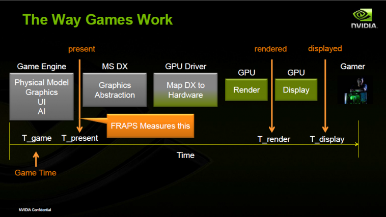

I have several games that give microstutter on my single GPU GTX 580.
I know that microstutter is generally said to be when you perceive a low framerate while the frame counter remains 60 (or whatever your monitor's refresh rate is).
According to this video: http://www.youtube.com/watch?v=2cH_ozvn0gA microstutter in multi-GPU configurations happens at the hardware level not at game engine level, meaning it can only be picked up by a capture card like the FCAT which simulates a monitor.
But I can pick up the single-GPU microstutter with Fraps's frame times, meaning, as far as I know, this is happening at the game engine level.
Here is an example, the game is BF1942:
Frame times:
FPS:
What's up with this and how do you fix it?

That fraps reading is so consistent, it appears you have v-sync on, and just not maintaining 60 FPS when you get the stuttering.

You have vsync on, so of course it will stutter when you drop below 60fps. Adjust your settings down. You may also be running out of VRAM, which also can cause stuttering. I know in BF1942 this is unlikely unless you are playing at a really high res.
You can also get stuttering when you have to load areas from disc, which some games are worse at than others.

Looking at the Fraps, it certainly is v-sync, it is not anything else. Just simple v-sync causing that. Notice the frames times are ~17ms the whole time until it stutters, and then it jumps to 33ms? That is v-sync.
