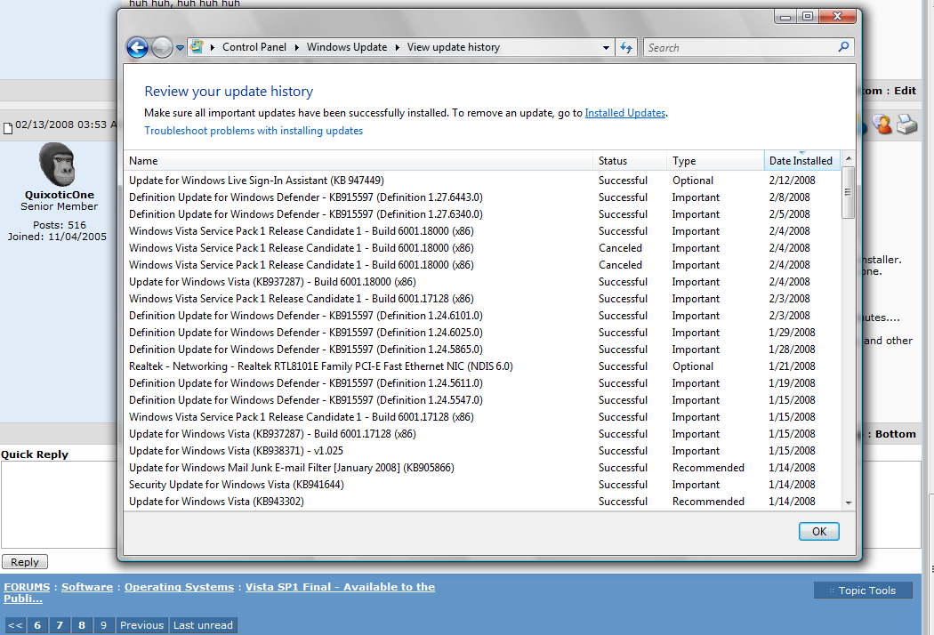

CHECK THIS OUT
You'll see that I 'Canceled' my SP1 install twice - or so it *seems*.
Actually, I pulled the ethernet cable out of my NIC several times during the install, just to see what would happen - if I could bork Vista... 🙂
A couple of times, this aborted the install and I had to reboot - those are the 'Canceled' attempts that you're seeing!
That's why I'm having a hard time buying into this whole thing.
Then, again, I didn't 'pull the plug' during the 'prerequisites' - maybe I'll try that next... 😀
Im confused on what you think MS is 'selling'. The Sp1 prereq update hung on certain systems, I dont know if MS has identified the underlying issue yet (Stash?). If the prereq didnt hang then you were in the vast majority. However, when your dealing with millions of clients even a .01% failure rate is lots of upset (and stuck) users. The fact that this update installed fine for you means just that, it installed fine for you (as it did for me, and Im willing to bet most of the other users here).
It's NOT MS that I'm having a problem with... 😉
It's the punditry in the electronic media that I'm having a hard time swollowing!
The 'unwashed masses' are finally starting to cozy-up to Vista, but there are STILL a lot of negativity towards Vista in the media - and 'they' take every opportunity to 'slip it to them'.
I've installed/uninstalled SP1, et al, several times. Sure, I've had a couple of minor problems with icons disappearing from the notification area, screen res getting switched, yada, yada, yada - but I think the media hacks are overstating the seriousness of this problem, in an attempt to claim some sort of hallow victory, like "See I told you so! Vista sucks! Stick with XP - a known good!"
And, having installed/uninstalled SP1 several times, I'm here to tell you... that stupid "1 of 3" / "x%" thing doesn't work correctly - and could EASILY confuse ppl into *thinking* Vista is locked up. I've *thought* that several times myself!
Ppl are just getting impatient, I'm sure of it! Bring back 'the animated marching drum/drumsticks'...
This is NOT a minor update, and it takes HOURS to complete, both installing & uninstalling...
Make more sense now? 🙂
