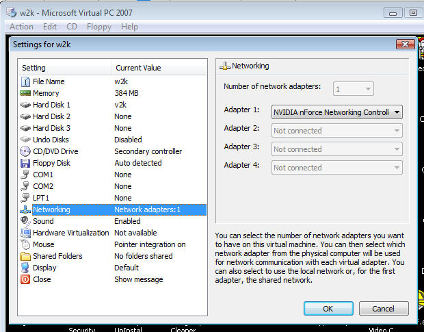

Look at the Device Manger of the VPC and make sure that there is a Valid Intel PCI Network Card.
Then Pull down From the Edit Menu the Setting and make sure that the Network adapter points to the NIC of the Host.
http://www.ezlan.net/example/VPC-Setting.jpg
Under this setting the VPC gets its IP from the Router, and act as an Independent Computer on the Network.

OK Jack, that worked. I can now Ping my router, and my host OS, but I can't get to the Internet. What should I check next?

Once it is basically working all the settings of the VPC's OS has to be like it is a standalone computer connected to the Router.
Does it get a valid IP from the Router?
Can you see the shared folders of the Host on the Network?
Can you open the router's menu through the VPC Browser?

At the moment do not change any thing sincce it seems that you have a valid Network.
Try to install Firefox and see if it works.
