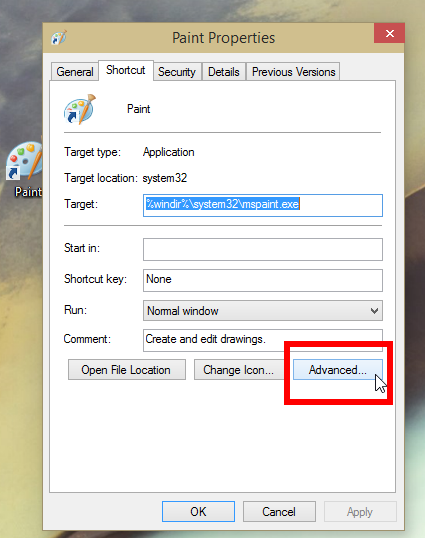

In case you need to always run the application as administrator, you can modify or create a shortcut which will start it always elevated. Right click the shortcut, open its properties and make sure you are on the Shortcut tab. There, click the Advanced button.
You will find the Run as Administrator checkbox, tick it and click OK. This is the native way to elevate a program's privileges automatically every time you launch it. You will still get a UAC prompt when using this method.

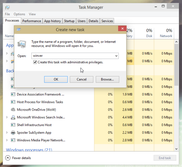

Using Task Manager.
The Task Manager app can be used to run software elevated.
  1. Open Task Manager

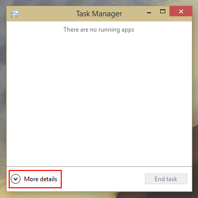

  2. Click the "More details" link if it looks like this:
  3. Open the File menu -> Run new task item. Drag the shortcut or EXE of the program that you wish to run as adminstrator to this "Create new task" dialog. Now check the option Create this task with administrative privileges and click the OK button.
You are done.

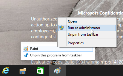

Using the taskbar and the Start menu.
For pinned taskbar icons it is possible to open them as administrator very easily.
  • Hold down the CTRL+SHIFT shortcut keys together on the keyboard and then left click a pinned shortcut on the taskbar. A new elevated instance of the application will open.
  • Alternatively, you can right click the pinned icon on the taskbar to show its jump list. Right click the program's name inside the jump list, and click on the Run as administrator command. As for the Start Menu or Start screen, you can click on the program's name while holding down CTRL+SHIFT to open it as administrator.
