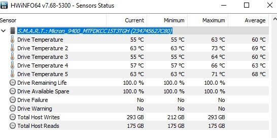

Hi All,
Just received this one and put it in my windows PC as a video editing drive.
Connected via startech u.3 to pcie 3.0 (i have an older aorus x299 board with x7920)
I am measuring idle temps and it''s running pretty close to max 70C op temp even when idle. Haven't hit throttling yet but a bit strange. My other m.2 drives are running significantly cooler...
Also what are these 5 temperature sensors? Which one is most important? Any input? Anyone using same drive and care to share op temps?
Thank you!

"Drive Temperature" is a composite temperature which is derived from a weighted average of the temperatures reported by the real, physical, on-die temperature sensors on the controller and NAND flash ICs (or perhaps a discrete temperature sensor IC).

Thanks, speed-wise I meant 1GB/s. Now, idle temperatures have stabilized a bit and went down by additional 5 degrees or so.
In the mean time I've emailed micron to ask about throttling mode performance and trigger throttle temp. Will post once I get a reply from them.
My most intensive write application is copying about 2TB of data from 5 SD cards simultaneously (80mb/s each) and that will definitely let me see if throttle mode is engaged. My prior 2TB 970 EVO PLUS never throttled while writing this to the drive, but maybe it did, but not noticeable at 400mb/s write speed.
I was watching a video of disassembly of 30TB 9400 drive on youtube and noticed that 2nd half of nand is actually facing the board and probably heats up a lot so definitely not a good idea to get 30TB version as it will probably run VERY hot. 15TB ,on the other hand , should be a sweet spot as it cools into the case heatsink

The Micron 9400 PRO is a 20-25W NVMe design in a 2.5" form factor. That's well over double what most 2.5" 15K spinning drives are and most 7.2K 3.5" spinning drives. It's 5x what many M.2 NVMe drives target. It's designed for servers that have linear data room temperature airflow coming across all bays. It's not designed to sit in a relatively static box with little to no airflow. You should definitely strap a fan onto this drive because even at idle it targets ~15W.

Just an update on my experience so far.
The drive sits 2 slots below my geforce video which actually helps as when i turn on active cooling on geforce card (3 fans) they partially help to remove the heat from lower slots as well. I have 4 total case fans and 2 cpu ones so airflow is pretty good. Micron software uses "drive temperature" value (1st out of 5 sensors on the pic) and throughout my 2hr testing it never went above 58 C which is good imo. I did extended 3TB - 2hr write @450mb/s and simultaneous reading and encoding at about 400-500mb/s read. Combined about 1GBps.
Idle temp is about 50-51C
So far pretty happy as it's a vast amount of storage with no write cache issues like on m.2 drives. Just have to see on the stability over the next few weeks. I assume if i was using it at full spec PCI-e 4.0 or even 3.0 (3GB/s) I would probably need to investigate additional cooling but then I have about 10C extra to spare until it reaches 70C and potentially throttles.
