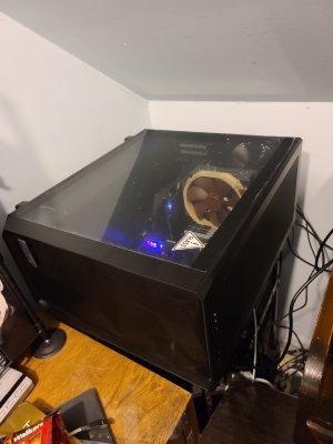

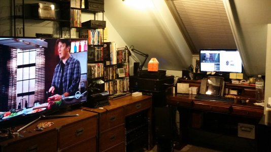

The space the computer will go is triangular under a sloped roof/ceiling.
I currently have an air cooled Fractal Meshify 2 lying on it's side in the spot, but it can't shed the heat under-load despite 9 140 mm fans in a positive pressure setup.
The O11D-Mini just barely fits. I couldn't find another case that would let me water cool both the CPU and GPU and fit into the space. I was considering the Phanteks Evolv Shift XL but it appear to only support a CPU block pump and I can't see how I could attach water to the GPU.
Also dust is a big issue and I couldn't see any easy way to protect against dust on the small Fractal case.

I did some measuring, the Mesh2 Compact might just fit. I will have to make a mockup and see.
The Node 804 would work probably. A North or a Focus 2 might work as well. I don't think the Terra is an option due to dust.
Can you think of any other cases I could look at or phrases I could search? I'm not doing a good job finding them on my own.
I added images of the space so you get a better idea.
Sadly, I don't have anywhere else the computer can go. I'm living a 1200 sq ft life in a 350 sq ft room.
I get that. I wish I could find a more condensed ATX case myself w/ using all NVME drives for Raid and a card for network there should be a better way.
So, the one thing that comes to mind looking at the photo is spinning the case or changing the fans to intake on the bottom, front, back, and exhaust out the top grill. Being in a corner is the biggest hurdle for air flow here. I can see why it's not cooling as efficiently.
Or exhaust the bottom and intake the other 3 as that might actually force the GPU to cool down and not heat soak the CPU.
For other options it's a mix of HAF high airflow. Looking for the 180mm cases like the torrent for more robust fans. There's a couple of HAF cases though that have 240mm fans as well. The problem then would be the dust factor if you're reluctant to clean it monthly or every so often.
Another option might be propping the glass panel at 45 degrees to allow natural heat exhaust to occur. This would mess with the air dynamics though but, if it drops the temps significantly it might be worth it.
The other option if you weren't using a GPU or maybe even w/ one in a horizontal mount maybe go the HTPC method. Silver Stone makes quite a few options. I considered them but, it would mean a different cooler and fans than what I have on hand. All the little stuff adds up though..
