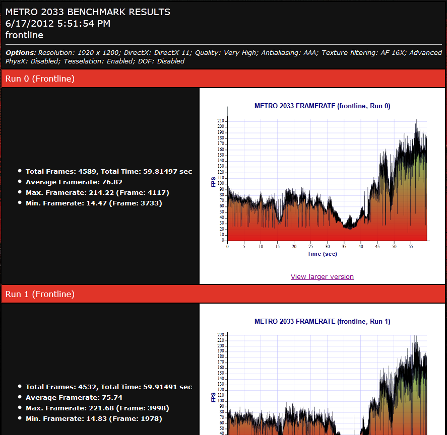

Ok I looked at the graph it gives and think it illustrates the problem:
See all those spikes where it drops down?? Is that not normal?

Hmm what's up with those thick black areas on the graph? Your graph doesn't seem to have as many drops or at least less severe.. I did another run with some higher level settings and get tons of drops, especially the beginning.
Options: Resolution: 1280 x 1024; DirectX: DirectX 11; Quality: Very High; Antialiasing: MSAA 4X; Texture filtering: AF 16X; Advanced PhysX: Disabled; Tesselation: Enabled; DOF: Disabled

Yes it's normal for the benchmark with Metro 2033.
http://www.overclock.net/t/817064/metro-2033-benchmark-thread-using-official-tool
How does the actual game feel for you?
If you want a frame time chart, use FRAPS with FrafsBenchViewer.
Doesn't do that with my 7970.
I have run that bench so many times too and haven't seen that. The only slow down I get is my the camera passes the tank and you are looking at that super bright spot light. I think I drop down to about 35-40 fps @ 1080 right there. If I drop the settings to the second to highest the fps go way up. Lighting absolutely kills framerates in that game.
