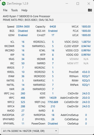

So I endend up getting it to run at 1800 but at looser timings. AIDA memory bench says that this is faster but I thought that 1600cl14 was pretty much the same as 1800cl16. Not sure its worth jumping down the rabbit hole of memmoruy tweaking to the exteme! I'm prety certain that I could tighten up those timings a bit but I'm not sure I can face the reinstalling windows because I corupted it by messing up the memory too much!
