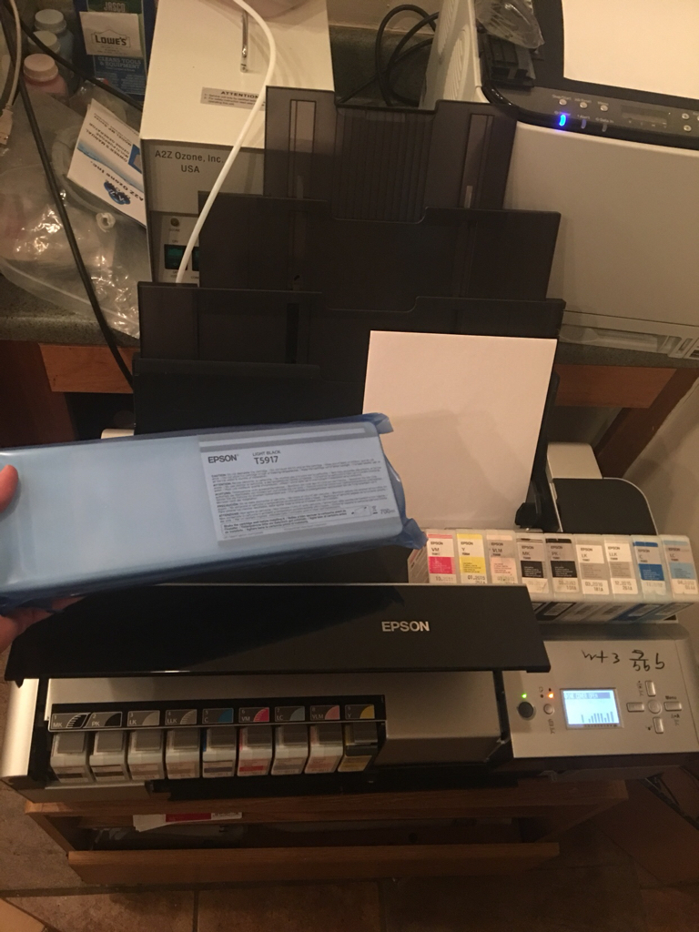

Though inks have expiration dates, they generally don't matter. I just installed some ink that expired in 2009 in my Epson Stylus Pro 3880 and it works great.

I recently got an HP OfficeJet 7000 Wide Format E809a printer from Goodwill and, sure enough, the printhead has some clogged nozzles that ruin photographic output. Was hoping to get lucky and get a decent wide format photo printer for cheap. That one was $6 and luckily a replacement printhead is $20 (most photo printers will be over $100 and impossible to self-install). Before I could get one, however, I came across that Pro 3880 for $10 (another Goodwill find). This one leaks Photo Black but works fine when you switch to Matte Black. All nozzles firing (*whew*).

If you’re doing photo or 17” wide prints, it’s hard to beat one of the older Epson Pro-series printers (Stylus Pro 3800, 3880, European SureColor P800, etc) with resettable ink carts. Because they use the same UltraChrome pigment-based inks in some industrial printers, you can get giant 700ml carts to extract and refill your 80ml carts. This way you can get economical 9-color photo prints with OEM ink.
Yes, the $1,300 MSRP printer cost me $9.99 at Goodwill but I had to spend $175 on a part (bad black ink switch). Even so, the included ink was worth more than that.
