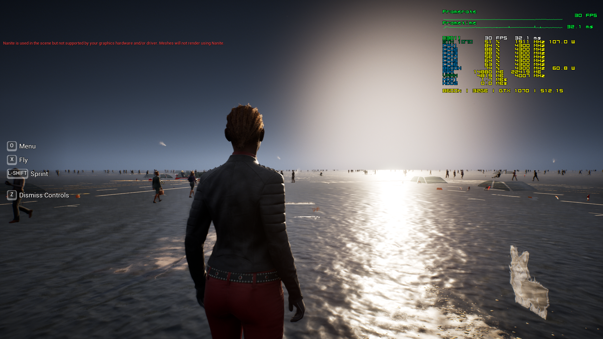

Just copied the whole thing to an external HDD to take with me during the weekend, to test on my 3060ti and it copied with a sustained 150MB/sec speed. So it's not like the drive does not have any more juice to give. I don't hear it accessing like crazy while running either, so it's not a matter of access time. I have a Gammix S11 and an EVO 850 and will test later.
Also it runs at DX11 mode, but the whole world is missing! xD

Meh running from the nvme does the same thing. 10-20-30MB/sec at most.
