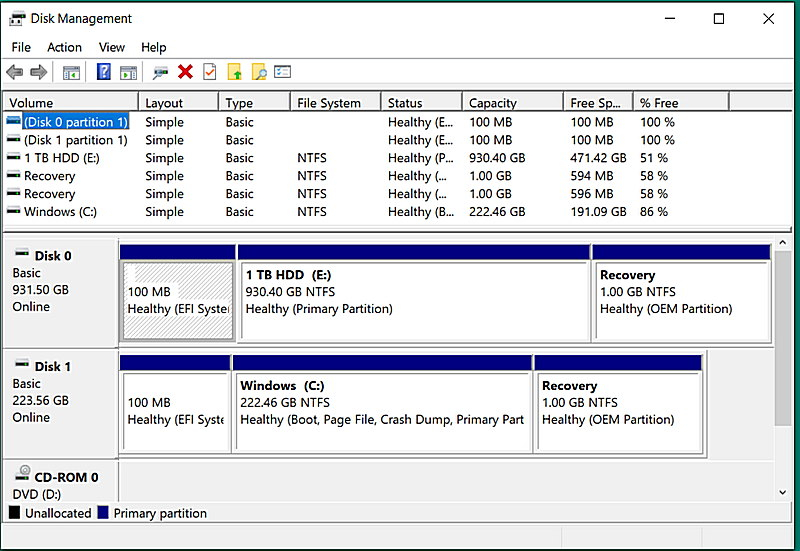

So I installed the M.2, set it as #1 in the boot stack, see pic, and it booted from the HDD, not the Adata M.2. To "solve" this I've removed the HDD, booted from the M.2, reinstall the HDD and reboot. Then the PC will boot from the M.2 but the HDD will be gone.

If both drives are visible and accessible when the system is booted from the hard drive, it shouldn't be a shared SATA port issue.
Did you ever determine what boot mode the laptop was set to using in the BIOS and also whether each drive is partitioned as MBR or GPT?
To determine the partition types on each drive, on the above screen simply right-click where it shows Disk 0 in the lower part of the screen, hit Properties, then click on the Volumes tab. Rinse and repeat for Disk 1.

Forgot about that request. Also confused partition with format. Do these screenshots have the answer?
Steltek
Mar 29, 2001
3,344
1,085
Yes, it does. Both are partitioned as GPT, so it isn't a partition issue.
