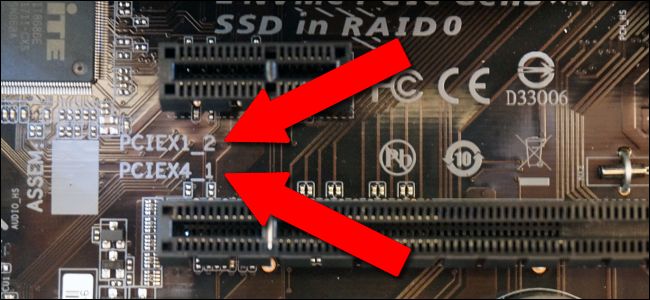

Can someone explain the PCIe x1 x4 x8 x16 slots to me and how can you tell where the slots are at on the different motherboards?. That's what i'm really struggling with the most right now. Also how can you tell the socket names?

You really will have to check the motherboard manual to be sure. But generally the numbering starts from the top. PCIE1_1 would probably be the topmost (closest to cpu) PCI-e 1x slot. PCIE16_1 would the first graphics card slot. But there is no standard naming convention that I'm aware of here.

As ping said. Depends on the board but the manual usually lists them and in the warnings like the one above they are labeled in the manual to match.
As for 1x. The littlest slot used usually for expansion USB3 or basical Gigbit or wireless addons. 4x is usually a little longer generally used for 10Gb or PCIe SSD stuff (its also typically what all M.2 connectors use). 8x and 16x are the typical graphics slots. Anything that does 8x is typically using a slot that is the same size as 16x but does 8x bandwidth.
The reason for this particular situation is that unlike Ryzen which has 4x PCIe lanes dedicated to NVME connections. Consumer Intel does not. Just 16x for the graphics and 4x to the chipset. So this is a way around that. 8x to the first Video slot and 4x to this M.2 port means that M.2 port isn't going through the chipset (where it may have 4x to the chipset, but then all chipset com including the SSD would go through a 4x connection).

Every motherboard I've used has the slot, DIMM, etc. number printed onto the PCB (motherboard).
