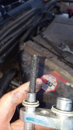

Many vehicles have a filter in the line going to the TXV and the evaporator to prevent metal fragments from entering. The rest of the system would need to be flushed or replaced to get rid of the contamination.
This is an example of the filters from a Tacoma Truck.
Contaminated from a compressor grenade event.

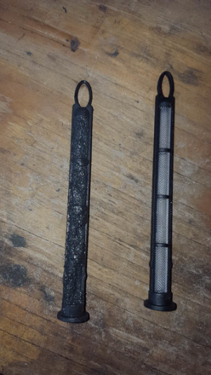

Below is a comparison between a new and a contaminated filter.
