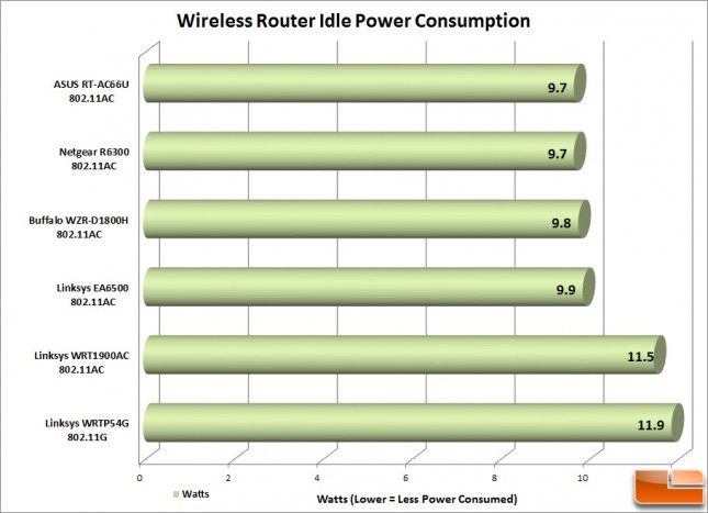

I've been looking to upgrade from my Linksys WRT54Gv8 to something a little faster, but in researching potential replacements, I was rather surprised to see how much electrical power the average "modern" wifi router uses.
For example, a table from a review for the Linksys WRT1900AC:
http://www.legitreviews.com/linksys-wrt1900ac-dual-band-wifi-router-review_146957/5
For comparison, my WRT54Gv8 measures at one single watt on my Kill-A-Watt meter, and the little power supply is rated at just six watts. The WRT1900AC apparently hits 18 watts under load and comes with a 48 watt power supply! :eek:
Searching for "low power routers" has proven difficult... as almost every result is about antennas, range, or some other aspect of transmit/receive "power". :|
And aside from Legit Reviews (Thanks!), at-the-wall power consumption doesn't seem to be something that review sites care about, unless the power adapter is especially large or the router produces unusual amounts of heat. :|
So that being said, does anyone know of any modern (or even previous-generation) wireless routers that are down in the low single-digits for power consumption? :confused:
