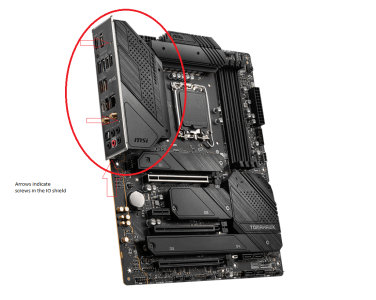

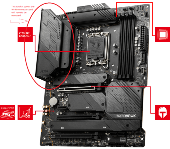

The antenna connections coming through the IO shield on my MSI Z690 Tomahawk Wifi DDR4 board are loose. I've tightened them as well as I can from the outside, but it's not doing the trick. I think I need to get to the other side of the IO shield to tighten/backup the nuts on that side...unfortunately, there's this big black "heatsink" covering that part of it.
I haven't pulled the board to see if there are any screws from that side that will allow me to remove it...and I DO NOT know if there are any thermal pads that would need to be replaced if I do.
Anyone ever do this? Suggestions?
There are a couple of screws holding the IO shield in place...and I think a couple from the bottom as well...marked by the arrows.

There's screws and should be four of them. They blend in with their surroundings. I pulled the what sink off another board to get at the WiFi card and swap it for a better one. It's easier to do before a build but, if you're going to pull everything to do it put the nuts on the outside.

I've watched a few videos where people have removed the heat sinks on the motherboard. There should be thermal pads there, but they shouldn't stick and tear like GPU pads. They should remain intact. Just go slow. Doesn't look like you have any RGB connectors to deal with once you have it loose either so that's good.
Here's a video of the Z790 version that may help. It shows the IO heatsink coming off around the 45 second mark.

Thanks for the video. That helps.
I had posted on the MSI forums and got very similar info. Looks like this is on my agenda sometime in the next week or two
