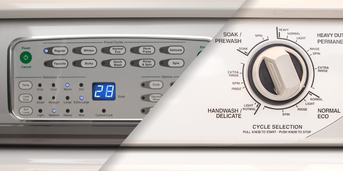

Unless your Speed Queen with "mechanical controls" is a pretty old set, it likely has a digital circuit board beneath the knob. Speed Queen doesn't advertise it, but they phased out actual mechanical controls a long time ago even on their commercial models. They just use digital knob controls disguised as mechanical controls for advertising purposes and consumer ease of use.
Well mine isn't ancient only 4 years old Model # AWN432SP113TW04. There are no electronic circuit boards inside. It has a mechanical Timer, Speed Queen Timer Part # 203387P.
As seen on linked page it is a mechanical timer with a motor.
It seems they still offer mechanical Timers, although they are pushing the electronics hard and offering a 5 year warranty for electronic controls:
You get a longer warranty.
We’re so confident in our electronic control washers and dryers, we back them with an industry-leading 5 year warranty on parts and in-home labor. That’s 5 times longer than the industry average. Our mechanical timer models are backed with a 3 year warranty on parts and in-home labor, which is 3 times longer than industry average.
Either way I would go with a speed Queen over any other Brand.
