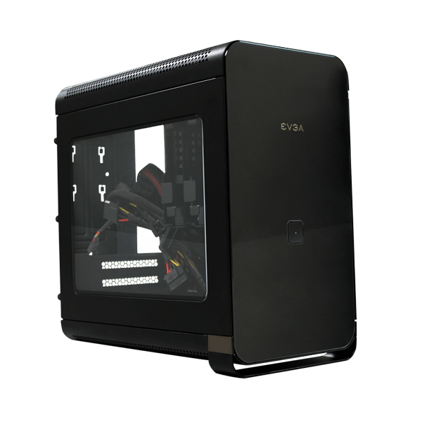

don't get one with built in power supply unless were talking about EVGA hadron.
Edit: Ack i see you want smaller..
