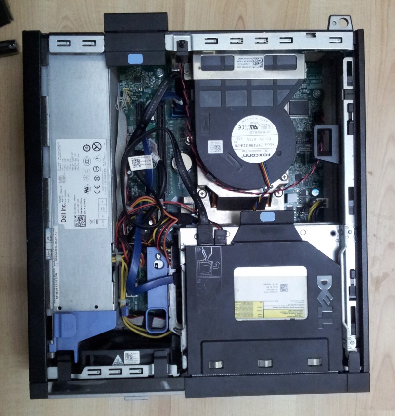

What are you hitting that is preventing you from having more than 7" clearance?
bradyapba
Nov 29, 2004
240
As you can see here, the HD cage, clips in, on the blue clip, onto a post stuck into the motherboard. From the blue clip to the back of the case, is about 6.9 inches.
