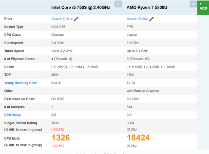

iu
What is compatible with this
I would like some 4 GB video,be able to stream 4K
There isn't a single part I can think of that's compatible with this antique.
