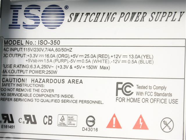

Inside, it came with an "ISO" 250W power supply. (Pic of label)
The fan on the PSU is getting really loud, and I am beginning to think that only having 250W split up between 4 HDDs, 2 optical Drives, and an agp 7600gt might be a bit much.
What wattage PSU would you reccomend, and do I need to get a special-sized one to fit in my case? Not sure if I need to shop for a microatx PSU, or if any size will work (It's been a long time since I worked with PSUs).

The six digit number indicates CWT was the builder, so it's probably a fair PSU.
With a quick search I could not be sure of it's size. Measure it. If it's 150mm wide, 140mm deep and 86mm thick, it will be ATX, proceed from there.

No you were not an idiot for using the 250W unit. You will be an idiot if you buy Antec for power needs.
