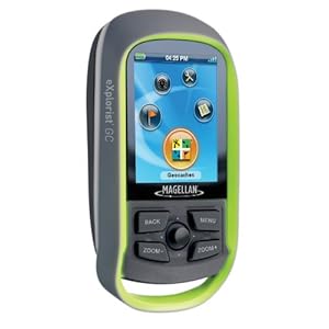

Just buy a little Garmin or Magellan hiking GPS. They will allow you to record a 1hz (1 point per second) track with WAAS (smartphones don't have WAAS) and get the track to your computer in GIS shapefile format easily. Each point will have a time stamp, with exact satellite time.
Some of them even last 20 hours on a couple AA batteries.

http://www.amazon.com/Magellan-eXplo.../dp/B003CYKYVQ
Product Features and Technical Details
Product Features
  • Easily connect to the Geocaching.com User Community and perform "Send to GPS," create and sync Pocket Queries, and upload Field Notes
  • Pre-loaded with the most popular geocaches in the world, found more than any others--get a complete out-of-the-box experience by searching and finding the top 1,000 geocaches worldwide
  • Easy to use with an intuitive user interface, simple controls and menus, and vibrant graphics
  • Vibrant 2.2-inch color transflective screen provides the best readability in direct sunlight
  • A high-sensitivity SiRFstarIII GPS with three-meter accuracy puts you on top of the cache and make the find that much easier
Technical Details
  • Brand Name: Magellan
  • Model: eXplorist GC
  • Connectivity Technology: USB
  • Battery Average Life: 18 Hours
  • Map Type: Worldwide
