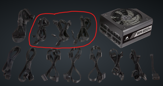

Hmmm, I would say don't trust Corsair support after that conversation!
Based on the image of the PSU from their own website the PSU comes with 3 PCIe cables and each cable has a pigtail for a total of 6 connectors. The GPU is rated at 300W. The PCI slot can provide up to 75W and each PCIe connector is rated for 150W. So 2 cables (using one pigtail) would provide 375W of power. I would still use all 3 cables that should be supplied with the PSU.
Technically, the cables with the pigtails can carry more than 150W in the cable because they use heavier gauge wire up to where the pigtail splits off. You should be fine with what is included with the PSU.

I just pulled my RM850x box out of storage and it did only have 2 PCIe cables shown on the box, so the image on their website (and Amazon) is wrong. But that also means that I only used 2 cables for my 6800XT which is rated at 272W (my MSI has 3-8 pin connectors on it) and it runs just fine. I believe I pulled a little over 300W during testing before I settled on 200W profile by undervolting. I firmly believe you do NOT need a third cable.

As for the PSU cables, you'll be fine with 2. Corsair uses 16 gauge wiring up to the first connector, then 18 gauge from the first connector to the pigtailed connector. Plus, all these PSUs are single 12V rail. Spreading stuff out over more connections can be beneficial, but you'll be fine if you use 2 (with one utilizing the pigtail). If you see anything funky happening, then pick up the 3rd cable (provided it is the right type - don't mix type 3 and type 4; follow whatever the manual says).
