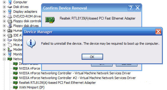

JackMDS
Oct 25, 1999
29,546
422
Originally posted by: bluestrobeAll you have to do is disable "unhide unused network connections" and then delete the profiles you want to delete. Windows renumbers the connection then. I don't know what you were doing and as the OP said above, it can hinder windows and create confusion among third party software that uses those connections.
Here I have a computer with NVIDIA chipset Motherboard; it comes with On board NV NIC.
A while ago, an additional Realtek PCI was installed and then taken out.
Unhide and try to delete, and that is what you get, Hidden NIC.
:sun:
