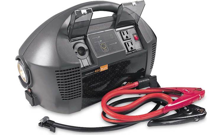

I've had one of these since about 2003, got a new $37 battery for it around '14:
However the inverter isn't very powerful, the inflator slow, the flashlight dim (incandescent, though I could change that if worth the bother, still enough to see what you're doing), so it's really just a box with a built in charging circuit for a 20Ah SLA battery.
Since I have a separate battery charger for other purposes, if I had to do it over again, I'd just get the same battery that my lawn tractor uses, throw it in a plastic ammo box, then use the jumper cables I have in the vehicle anyway.
