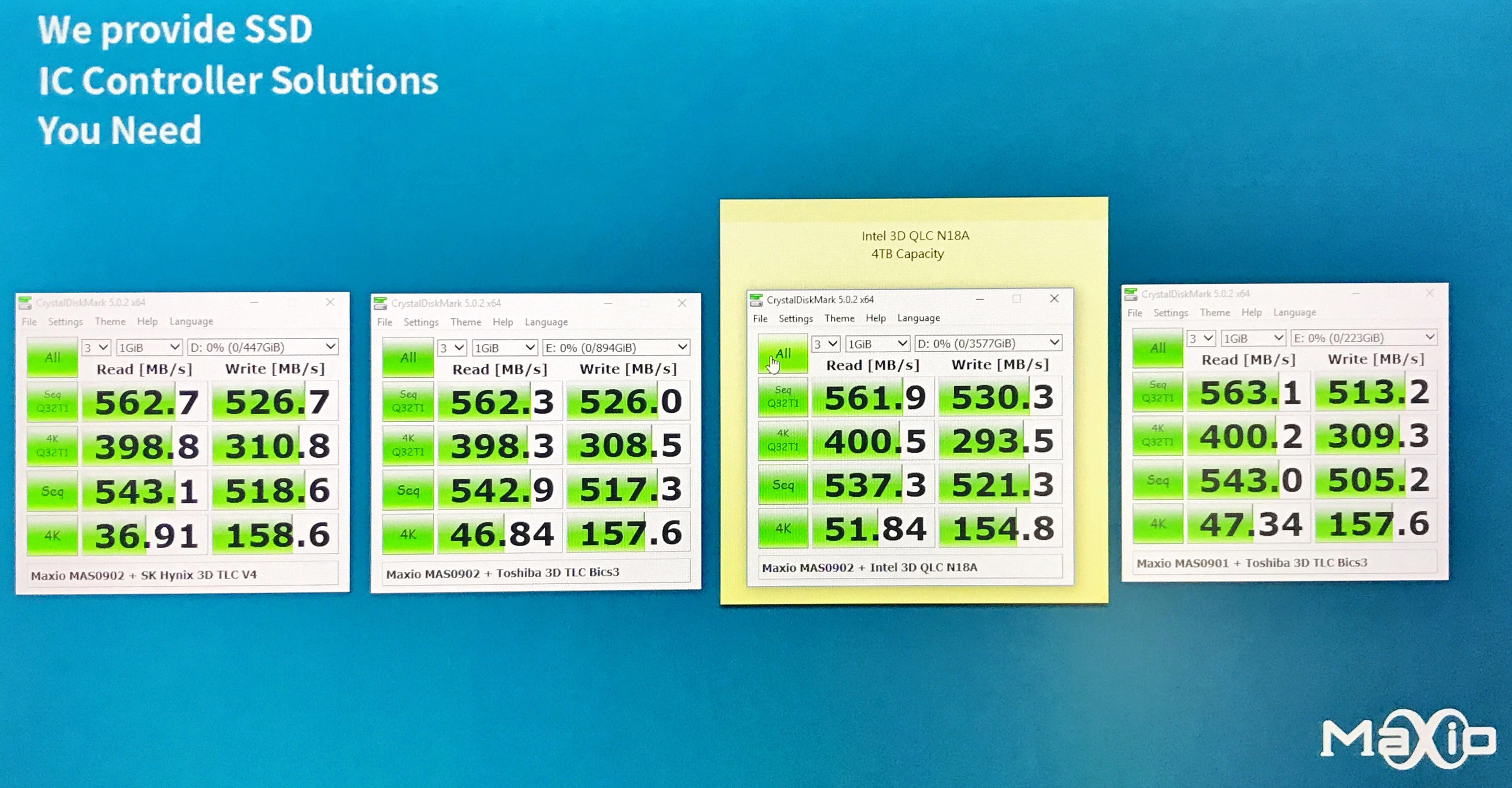

A new dram-less PCIe 3.0 x 4 controller for Maxiotek
https://www.tomshardware.com/news/maxio-ssd-qlc-96-layer-slc,37199.html
aHR0cDovL21lZGlhLmJlc3RvZm1pY3JvLmNvbS9VLzAvNzc3Mzg0L29yaWdpbmFsL05WTWUtMXIuanBn
(The version with dram buffer is called MAP0901)
P.S. It was also noted in this article that the Maxiotek MAS0902 dram-less SATA controller mentioned in post #65 is built on GF 14nm, so this one I would think would be on 14nm as well.

I'd believe these speeds when i see them tested in an end product.
I am guessing the 4KQD1 read is high because the controller is using the NAND as SLC.
According to this review of the 480GB SU630 Ultimate (with the same Maxio technology MAS0902 controller as well as Intel 3D QLC NAND) gets 24 MB/s.
Still 24 MB/s (which I assume is using 3D QLC, not 3D SLC) is not bad because I know SM2258XT SSDs with 3D TLC are doing about the same.
P.S. With the Phison S11 reference design using IMFT 3D QLC it would be very interesting to see how MAS0902 compares using the same 3D QLC NAND.
