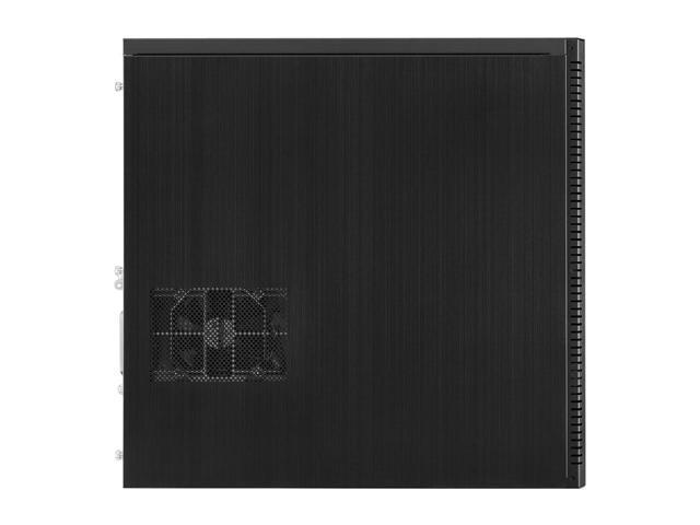

DaQuteness, my case already has a side panel exhaust.
http://c1.neweggimages.com/New...mage/11-112-105-03.jpg
In this configuration, I have found the best place to place the side panel exhaust is to the most rear point (left in the picture) of the case. Seems to keep the cards the coolest. It is pulling air from my bottom intake - the one I need the hole for. :)
