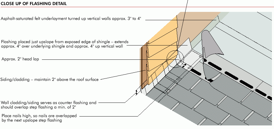

IMHO, the flashing is correct. The flashing is going up behind that (vinyl?) siding below the rakeboard. The problem is that the rakeboard is so rotted that the water is getting behind everything.
http://www.civil.uwaterloo.ca/beg/Drawings/Wall_files/APA_wall-roof_flash-1.gif
And I am sure the J-channel he is referring to woudl go on that vinyl, like this link: http://www.taunton.com/finehomebuilding/media/h00110_09.jpg
