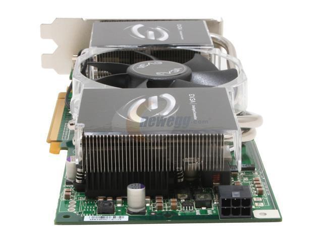

They are talking about the 6-pin power connector like the one on this card:
http://images10.newegg.com/NeweggImage/productimage/14-130-058-04.JPG
It is just another way of saying that the card needs to be hooked up to this plug. The 6800GT PCIe uses the same plug, so you should be fine.
