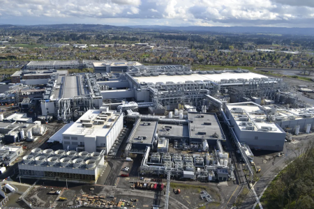

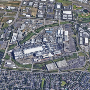

So Oregon is just for development?
I can say personally ( I live right next to the facility) that a lot more than development must be going on in there. Its many square MILES of buildings. The manufacturing end must be large also. The power grid around it is insane.
Just one picture. The building in the middle is 8-10 stories tall. This picture belies the actual size.
Another. You can't even make out cars, as they are so tiny compared to the building.
You think those are big factories? You have never seen major factories then because although large they have nothing on food producers, which in turn have nothing on the heavy industrial giants. The big boys have their own rail systems moving through and around them.
controlflow
Feb 17, 2015
73
83
It isn't exactly a rail system but I think it is a lot more interesting.
Since this video, they completed a large expansion of D1 and have another one planned supposedly.

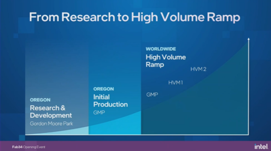

D1 in Oregon is indeed both development and HVM.
