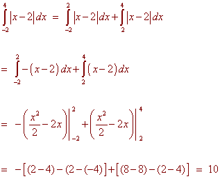

so for your example, the turning point is 5/3. anything greater will put a positive value in the abs, and anything less will put negative.
and then I THINK you do intergrals for both. so like if what is inside will be negative, you would take the integral of -f(x) for 0 to 5/3, and the intergral of f(x) for 5/3 to 3 and add them
or perhaps you subtract.... ugh lemme look this up it's killing me
ahah i was right, you add them.
http://www.ltcconline.net/greenl/courses/116/IntegrationApps/fstfun19.gif

41/6 ....

When x <=5/3 : |3x-5| = -3x +5
When x >=5/3 : |3x-5| = 3x - 5
Integral |3x-5| from 0 to 3 = Integral of -3x+5 from 0 to 5/3 + Integral of 3x - 5 from 5/3 to 3
that's it
