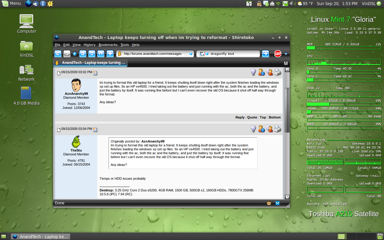

Crank up Conky! 😀
http://www.vindsl.com/images/Conky-Toshy-20-SEPT-09.png (VinDSL.com - current Conky stats)
