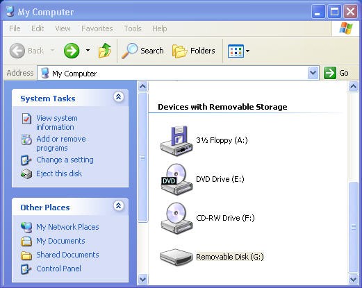

I want this on the side of my laptop:
Then use this cable:
And plug it to another computer like this:
Then have it show up as a removable drive like this:
Imagine how much easier it would be to move files when you get a new laptop, or if Windows won't boot but the PC still powers up you could probably still access your files.
