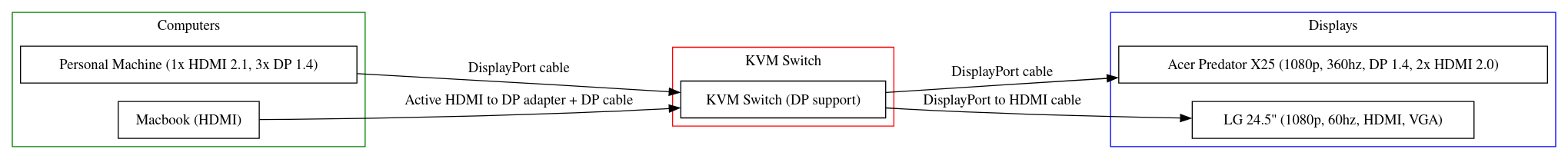

I appreciate you taking the time to explain this. Just to make sure I follow, is this what you're suggesting?
VirtualLarry
Aug 25, 2001
56,580
10,217
yeah, that's what I'm suggesting
Edit: My bad, I was assuming it was a 2x2 matrix switch. If this is a more traditional uni-display KVM, then no, what you want isn't possible.
Sorry.

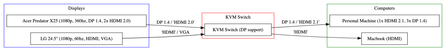

Alright, I got a HDMI->DP adapter and a DP->HDMI cable and hooked everything up like in the diagram.
Bizarrely (to me), everything works except that the secondary monitor is not detected by either machine. Switching between machines works fine, the primary display works fine, but the secondary display doesn't get any signal and doesn't show up in display options / xrandr. What might I be doing wrong there? Is it possible I somehow got the "wrong" DP->HDMI cable? https://www.amazon.com/dp/B07ZQ7K6S1

I am not aware of any KVMs that support multiple displays over a single cable. Does the Macbook not support Displayport over USB-C?
KVMs can be rather picky about cables in theory that cable SHOULD work, but maybe it needs an active adapter like this one https://www.amazon.com/dp/B077JB28KM?th=1
