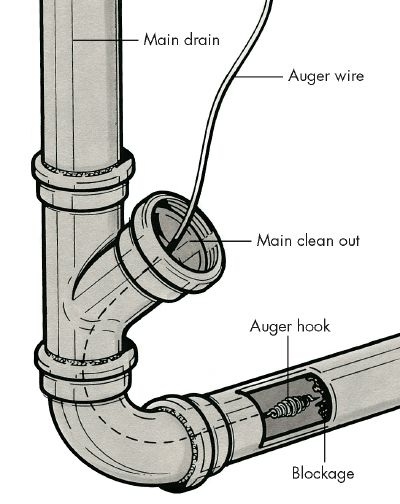

You said you are at 10 feet? That seems like your next task is find something like this...
since 10 feet into the pipe usually means the blockage isn't there...
