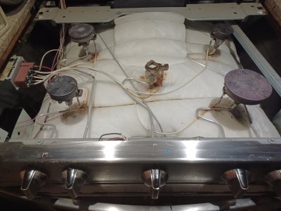

It's getting worse. All burners (except center one, completely forgot it) are now difficult to start the fire, randomly.

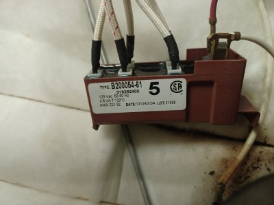

Opened the gas range top and saw this spark module 316262400
so maybe I should replace spark module 316262400 first?
instead individual surface burner orifice assembly?

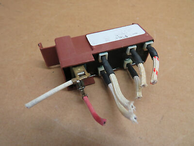

search the ebay and found that 316262400 costs at least $70 if new and found the following video
The Frigidare gas range top looks exactly the same as my Kenmore. So the spark module 808608804 should be compatible? Like this one on eBay? https://www.ebay.com/itm/126477705252 (at least with a Frigidaire bag)
Or even the one from Samsung? https://www.ebay.com/sch/i.html?_from=R40&_nkw=DG96-00297A&_sacat=0&LH_ItemCondition=3&_sop=15
Kenmore outsourced to a bunch of actual appliance manufacturers. Electrolux is one of them.
No idea if this helps, but 790 is Frigidaire (Electrolux)
